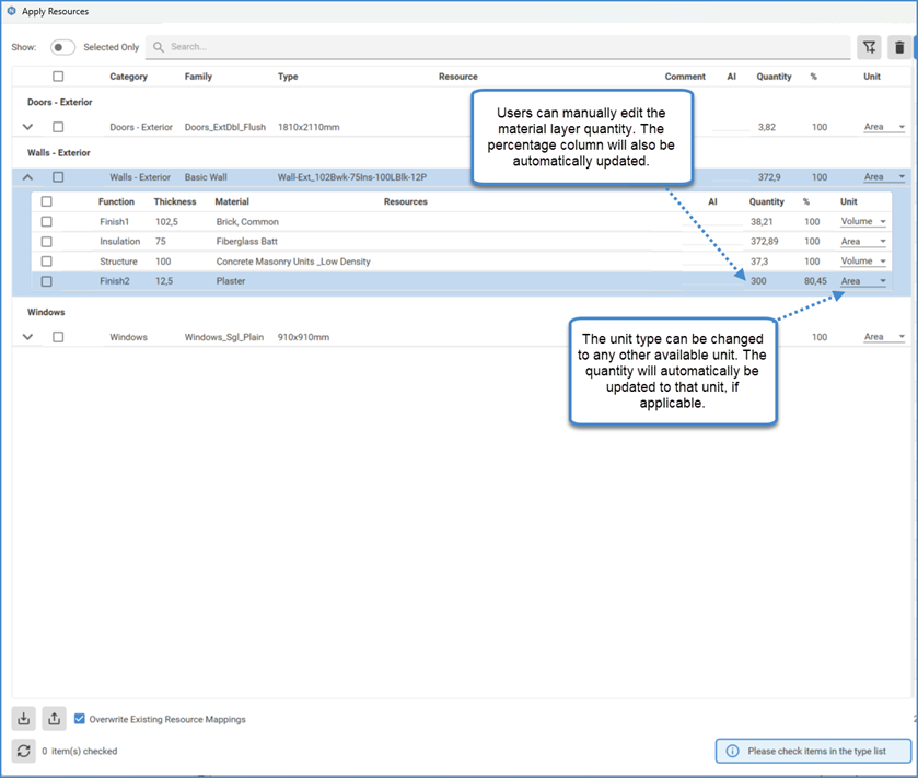

Apply Resources - Quantities
Apply Resources has been updated to give you clearer insight and control over what goes into your CO₂e calculations.
Users can now view material quantities for each family type, including a breakdown of their individual material layers. These displayed quantities represent the exact totals used in the CO₂e assessment, ensuring full transparency in how results are calculated. Additionally, users have the option to manually adjust the displayed quantities when necessary, ensuring that calculations can be tailored to project-specific requirements or refined inputs.
Apply Resources - Material Update
Apply Resources has been updated to display all material layers of System Families individually. Previously, layers composed of the same material were grouped together. With this enhancement, users can now also view the function and thickness of each layer when applying resources. This change does not affect Loadable Families.
